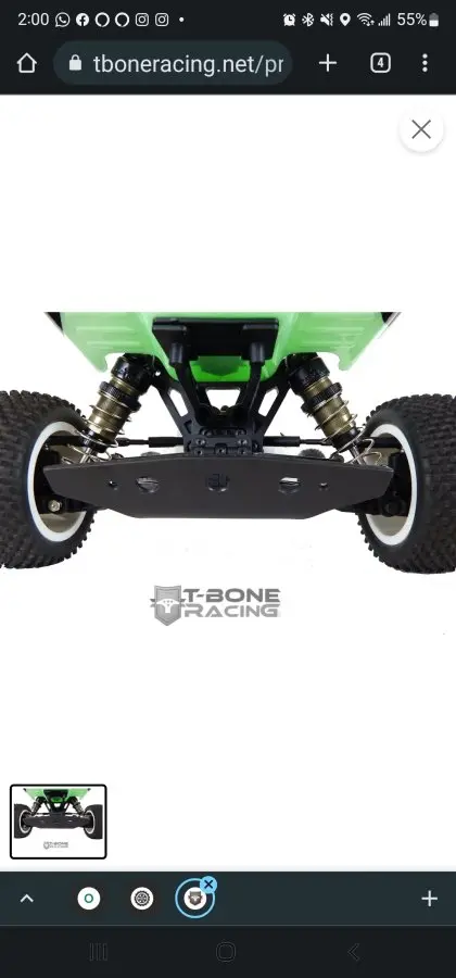

Looking to upgrade the eb410 front and rear bumpers, but I cant find any, if I find some eb410.2 bumpers will they fit the eb410? i want something like this

If you find something for the .2 that mounts through the chassis into the bulkhead like the t bone, it will fit
TBR recently went out of business, however you can make those bumpers yourself fairly easily... simply buy some 1/8" Kydex on Amazon and cut the bumper with a dremel then trace the holes to be drilled with a piece of paper and pencil onto the bumper, you can shape the bumper into any angle you want using heat from a blow dryer or heat gun.
