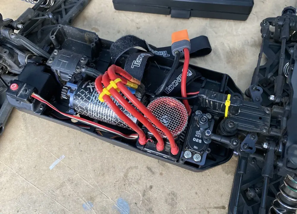

So went for an ESC swap to see if I can get my issues sorted out..?

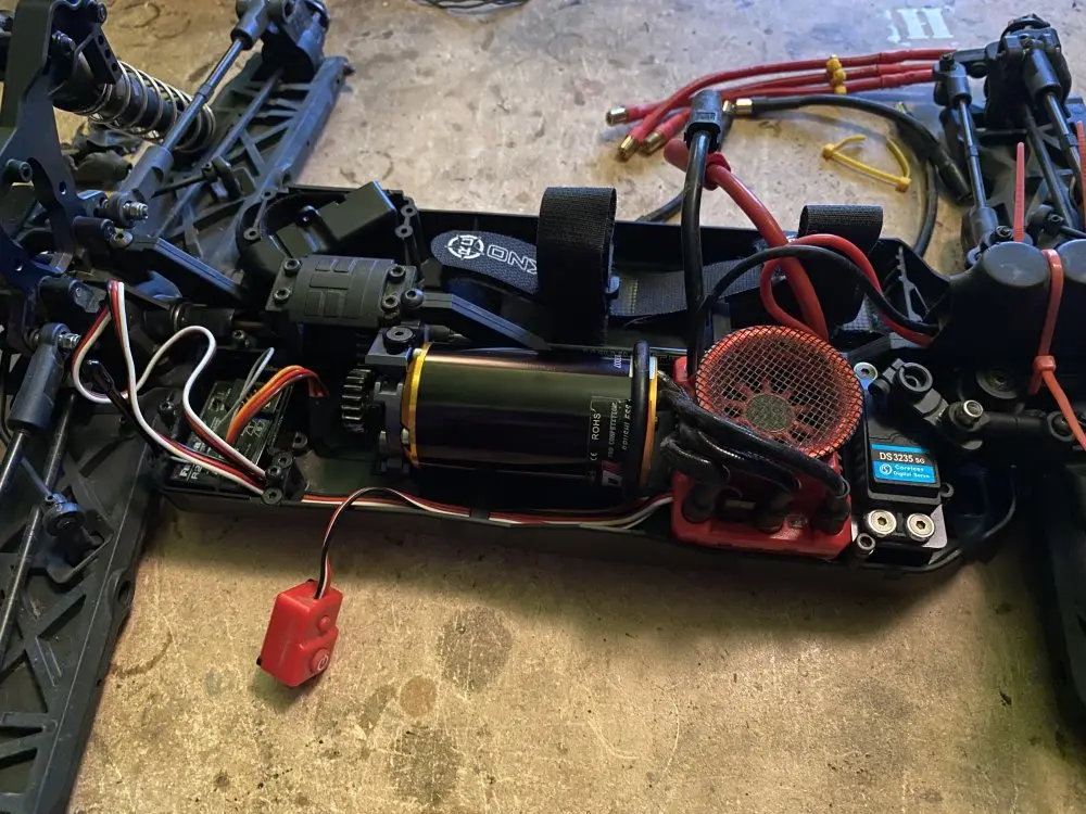

I've now fitted a Max8, I like the Max8 because it has 7.4v to the servo and more settings to play with over the Arrma BLX system, one of my favourite settings is the adjustable LVC..??
Personally I think it's worth the upgrade just for those two settings alone..!!
I had to make some extensions for the motor wires, not my tidiest work but hey it does the job..??

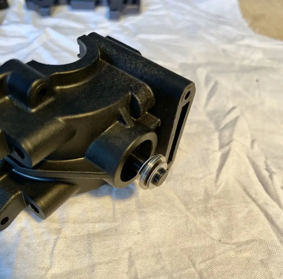

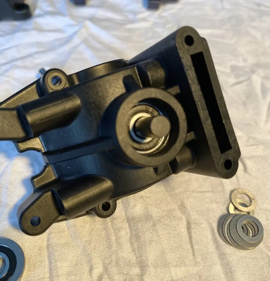

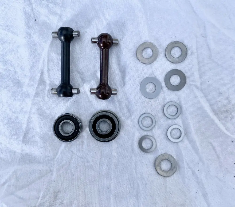

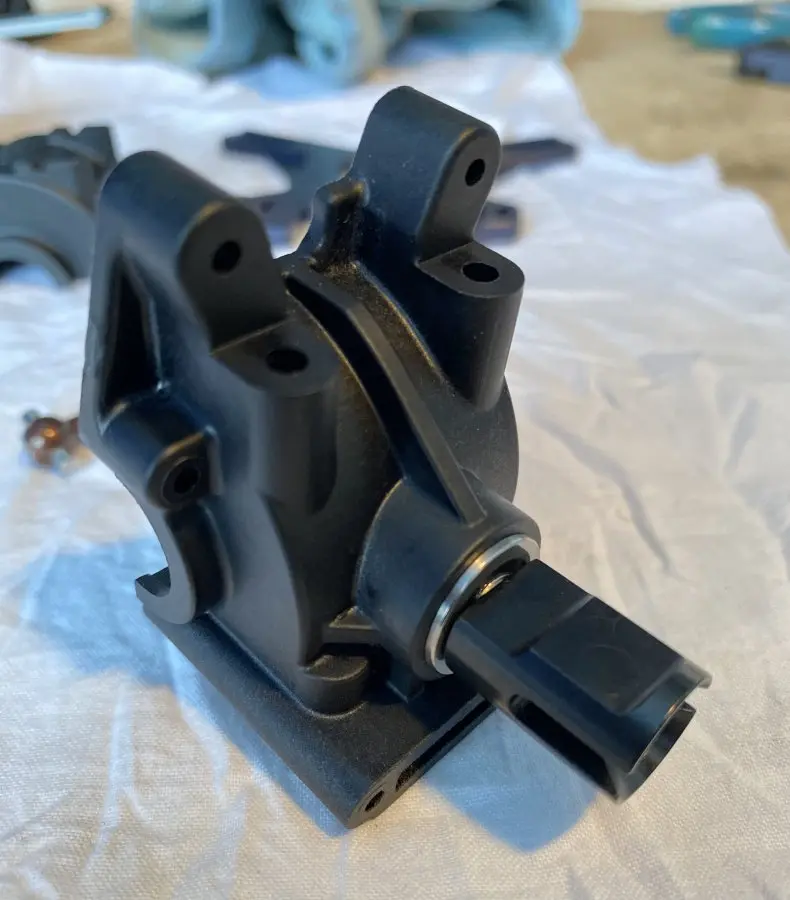

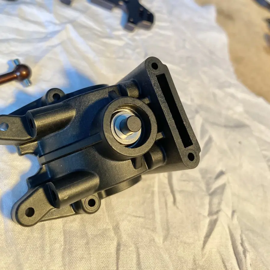

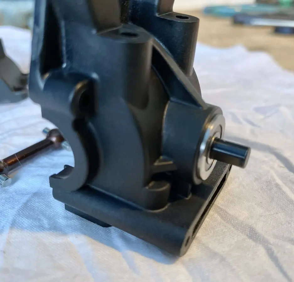

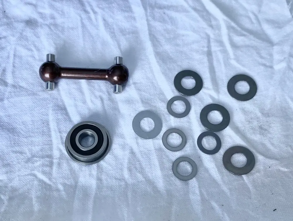

I had read online from numerous different sources that the rear diff bearing can get punched into the diff case causing major damage to the pinion and crown, so I thought I would research what parts were needed to stop such an issue..
Below are the parts I used to convert the rear diff housing to be "bombproof" as they say, it consists of a shorter rear drive shaft, bearing with a flange and 2.45mm of spacers or shims.
( I need to file the ends flat on the dogbone, but that will come later ?? )
Here is the standard bearing and dogbone on the left vs the upgrade parts on the right.??
Some install pics of how/where the shims go..?
View attachment 4505View attachment 4506View attachment 4507View attachment 4508View attachment 4509

@YoEddy .. I got the part specs from another thread on here, I can't remember what one exactly though :unsure: I think it may have been "Overkill's" MT410/ET48 build thread ??

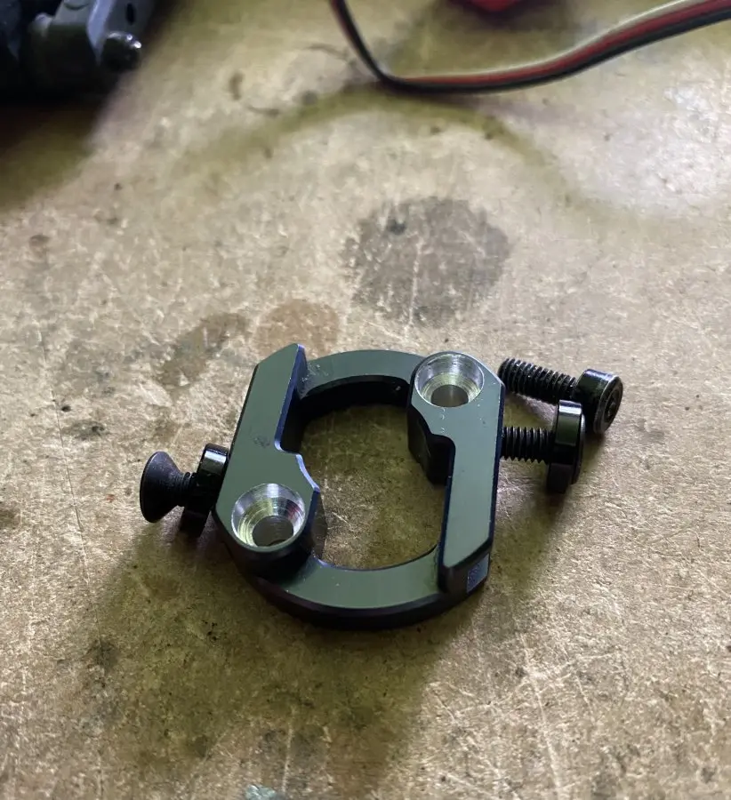

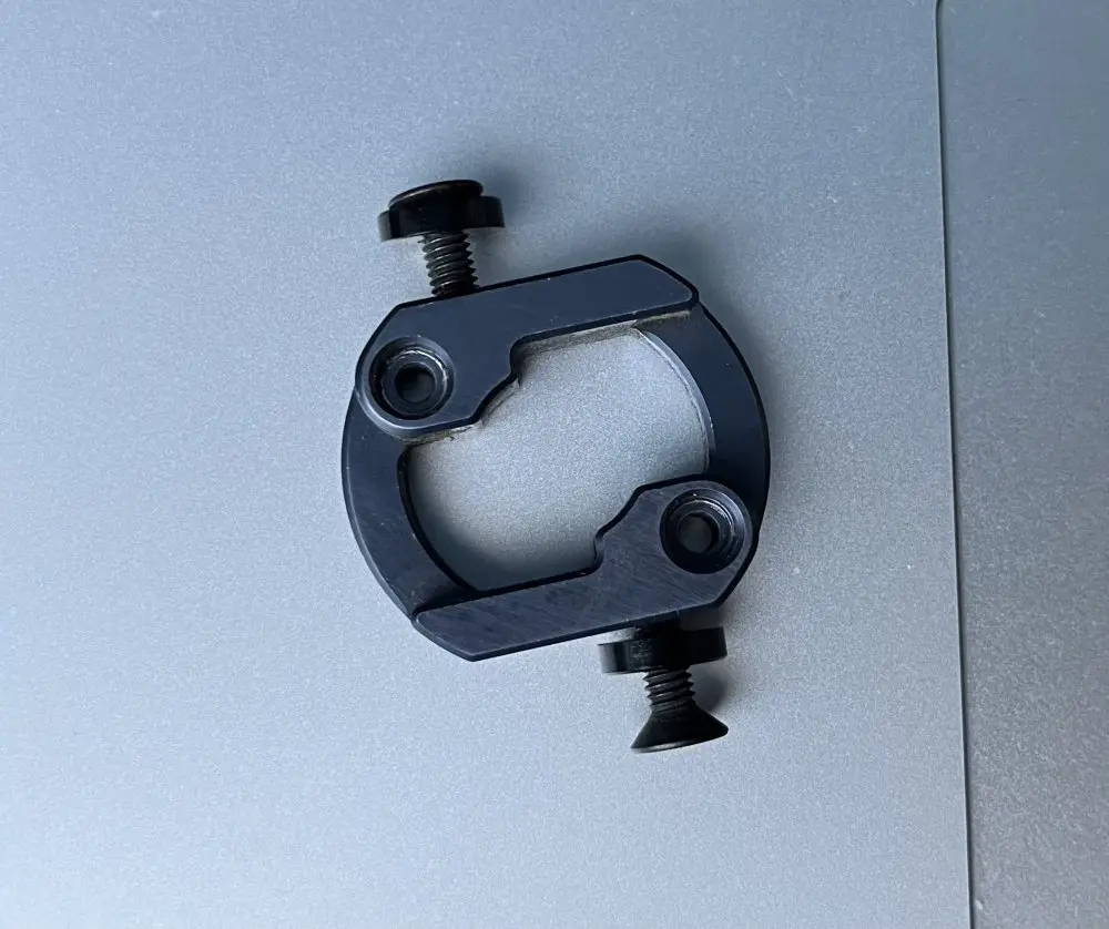

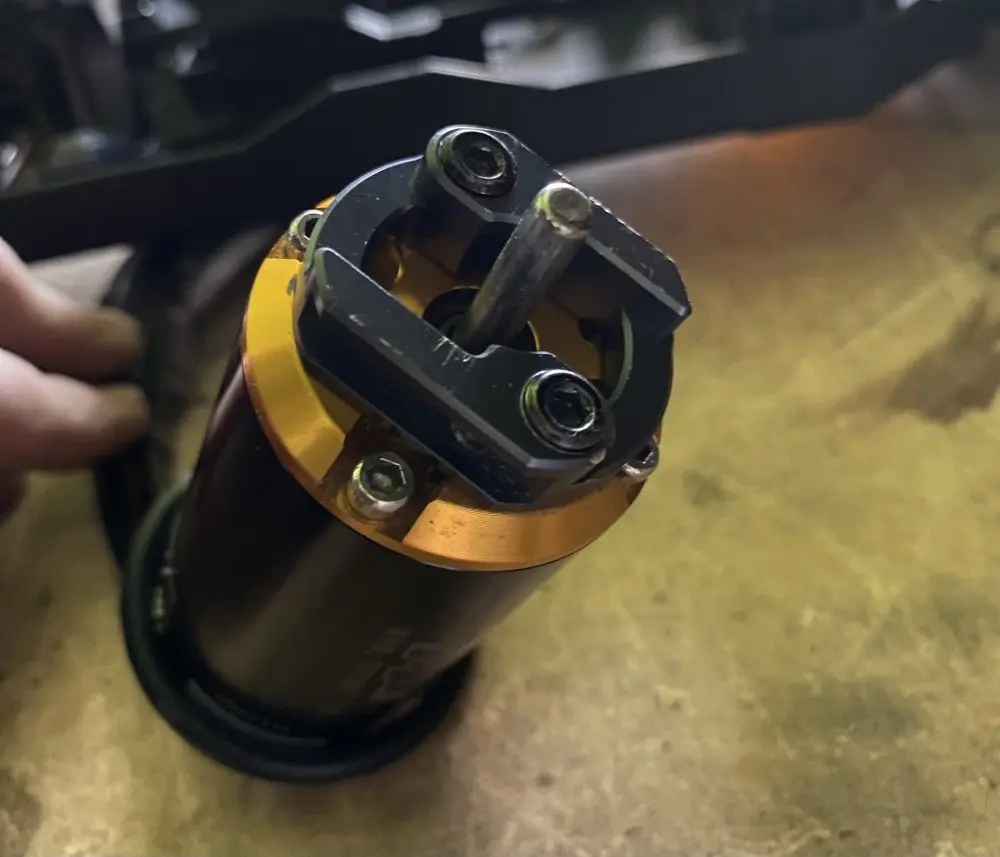

I wanted to fit a TP motor I had lying around and found out that the motor mount is only drilled for M3 😩
Decided to drill the current mount to M4 as I'm too impatient to wait and buy a new mount..!!

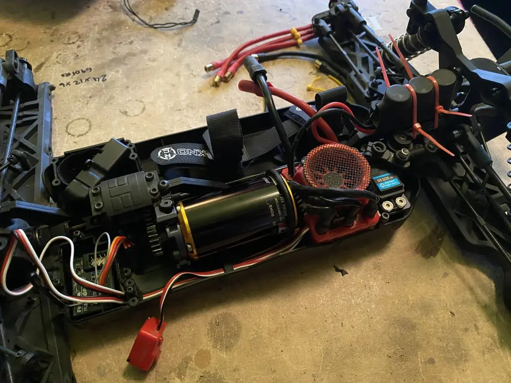

All mounted up ready to fit..
Fitted TP motor, Futaba rx and Corally Torox ESC complete with tunnel stack intake.!! It's now a Corally powered monster..!!🤯😵‍💫
Corally's ESC is just crazy ( like it's just got some extra magic inside ) for those that know, you know.!!
Mine also has an added secret weapon though, a custom spec cap pack.
Stay tuned for more soon..!! 😎
